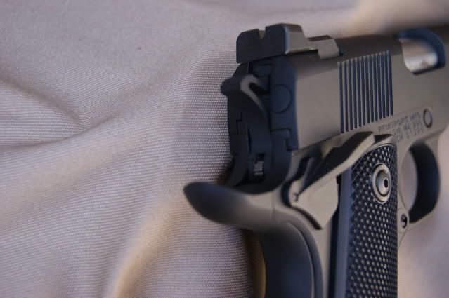

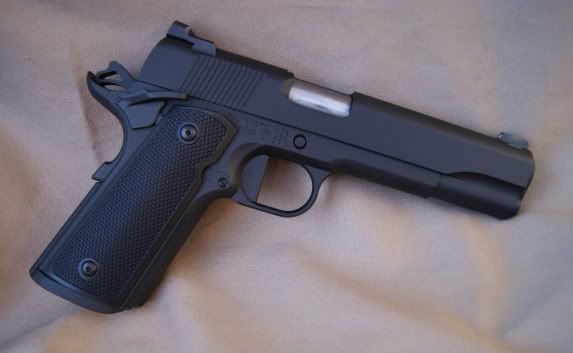

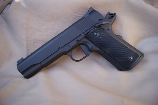

Hopefully Tent can takes some better pics than me.
10-8 Trigger , Slide Stop & rear sight
STI Tool Steel Hammer & S-7 Sear
Colt disco & Sear spring
S&A Grip safety & Magwell
Caspian Ambi & Ejector
EGW Hardcore Extractor

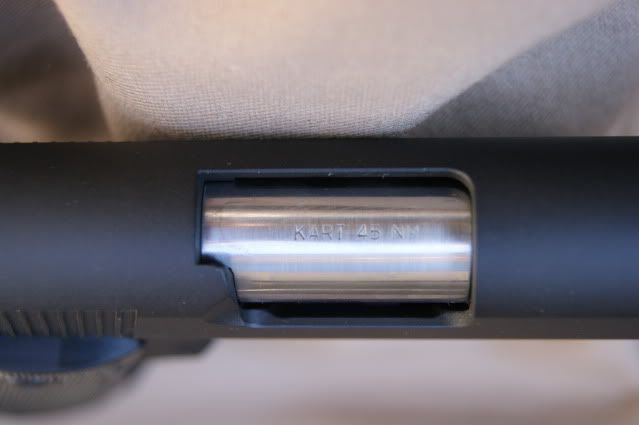

Kart NM barrel
EGW custom Engraved Bushing & plug
Armorer's Black Cerakote

Ejector was replaced with a Caspian one because the one it came with wasn't installed very good.
Barrel was flush cut and deep crowned
Mild dehorn on the entire gun
frame was recessed and slide stop was flush cut.
Magwell was blended.
Slide was also tighten because it was a bit loose for me.
Here is the list as I had it saved... I think all the parts are correct...
Remsport Slide and Frame with Ejector and Plunger Tube
Kart National Match Barrel
EGW Grip Screw Bushings
Caspian Ambi TS
10-8 Flat Trigger
10-8 Slide Stop
10-8 Mag Catch
10-8 U Notch Rear Sight
Smith and Alexander MSH Magwell Combo
STI Spur Hammer
EB Rebuild Kit
STI Match Grade Sear
Colt Sear Spring
Colt Disconnector
EGW Firing Pin Stop
Wolff 16lb Recoil Spring
Wilson Bullet Proof Firing Pin
EGW GI Guide Rod
EGW Monogram Bushing and Plug
Smith and Alexander BTGS
