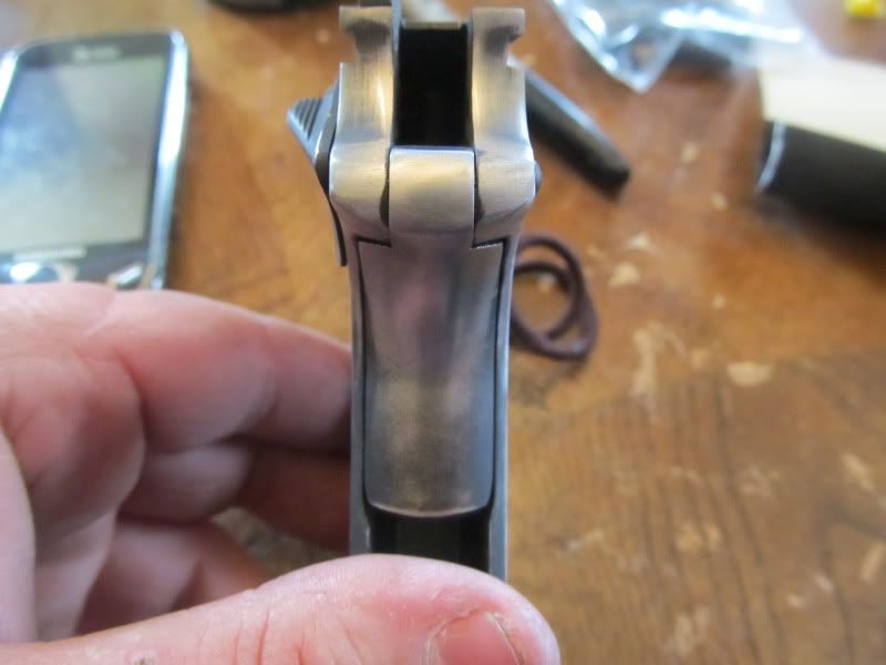

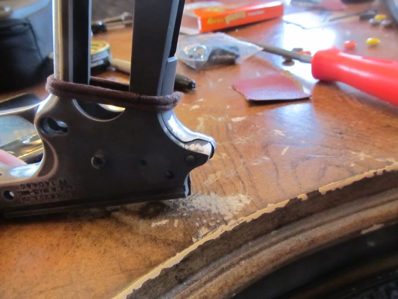

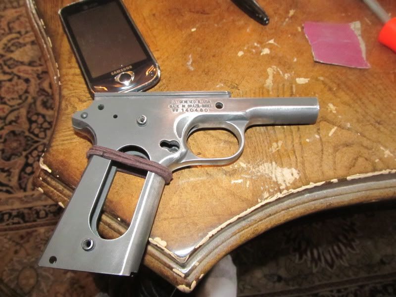

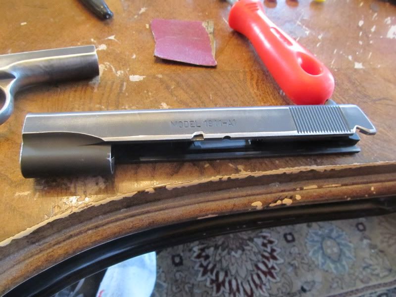

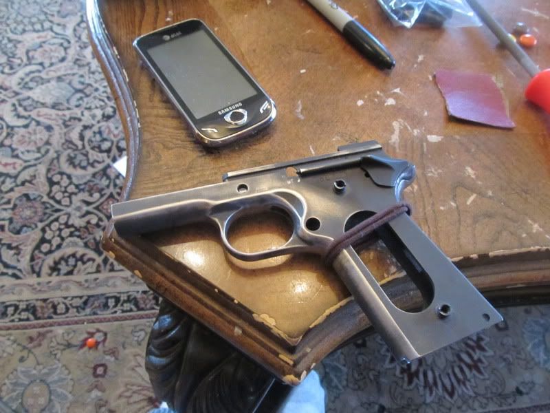

started this last night for my girlfriend. It's a basic SA G.I.
dehorned frame and slide
angle cut on bottom of slide

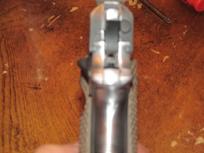

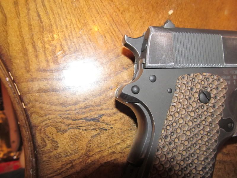

bobbed grip safety
bobbed hammer
things still to come:
blend frame and slide at the rear
new barrel/bushing (stock on is very sloppy)
tighten frame to slide
flatten slide stop
flat checkered MSH
round butt
flat trigger
c&s ignition kit (will bob that hammer too)
checkered FS
novak sight cuts
sights of her choice
lower and flare ejection port
was a learning experience, and the first one that ive done all by myself. will be doing everything myself, with help from a gunsmith friend with the milling components. i think she wants to do a matte black

Looks great man.

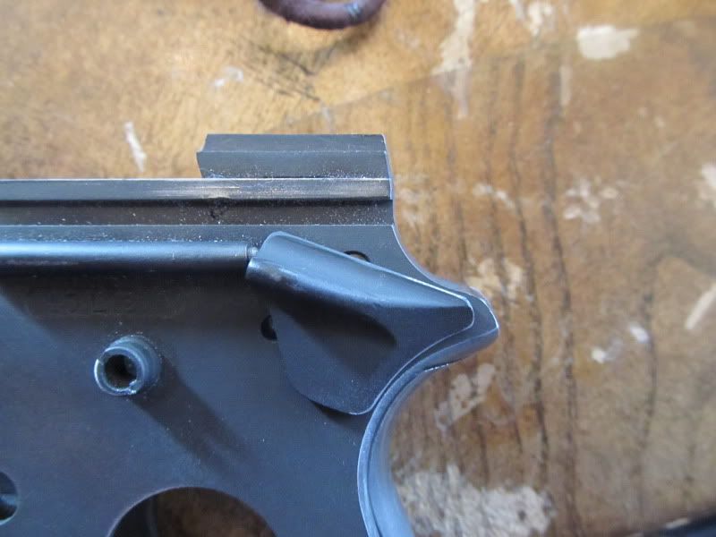

Wonder how the slide stop notch will hold up w/ the beveled edge.
26,205 Posts
Lookin good,.......looks like a LOT more bevel than I did on my Loaded project.
I was not as motivated as you. I like the bob'ed hammer & GS.
Have you thought of a finish?

she wants black of some sort.... the bevel on the slide stop looks more announced than it actually is. there is still a lot of meat there... probably 90%. there is quite a bit of bevel on everything, but thats what she said she wanted when we looked through a lot of pictures...

I hope you're enjoying yourself. I know I do when working on builds. I am, however, concerned about the amount of metal you took off beveling the slide stop notch. I do hope it holds up.

Just an example of what I was originally trying to refer to. Notice how Chuck stop short of the slide stop area.

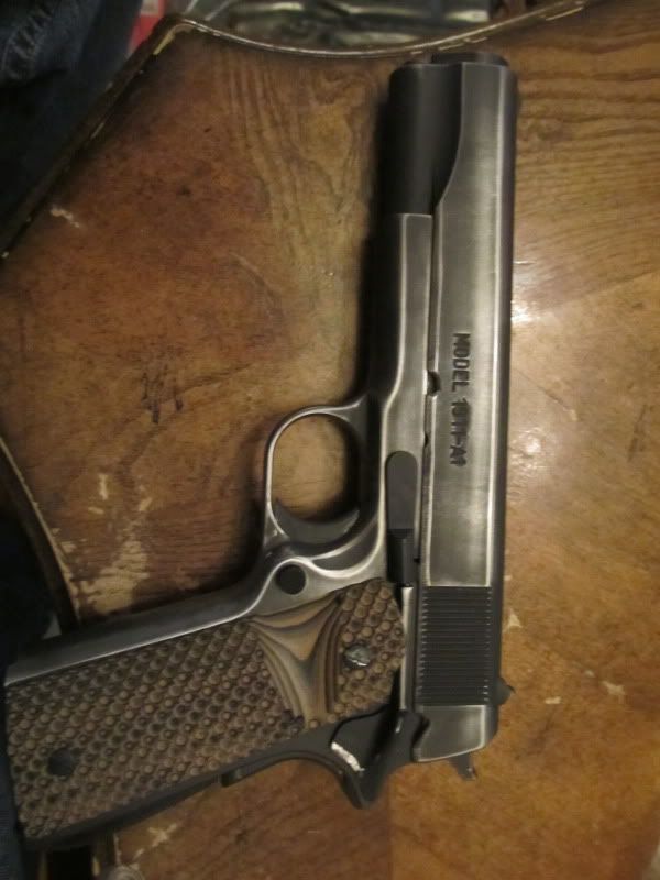

fit the trigger from my trp into it, and did a little cleaning up to the stock ignition system. its not beautiful, but it breaks at 5.5 lbs and is pretty crisp. She wants a flat trigger, and i may see if i can talk joe out of one of those short flat triggers.

I've also decided that i am going to go ahead and cut off the hammer and make it non cockable with the thumb. just ordered a 10-8 flat trigger, 10-8 rear sight and brass front sight.

put in a 10-8 flat trigger, and recieved the sights. also beveled the the barrel bushing, and i think it came out nicely for my first time. undercut the trigger guard. still needs some work around the front of the slide, but im to tired to do it tonight.
