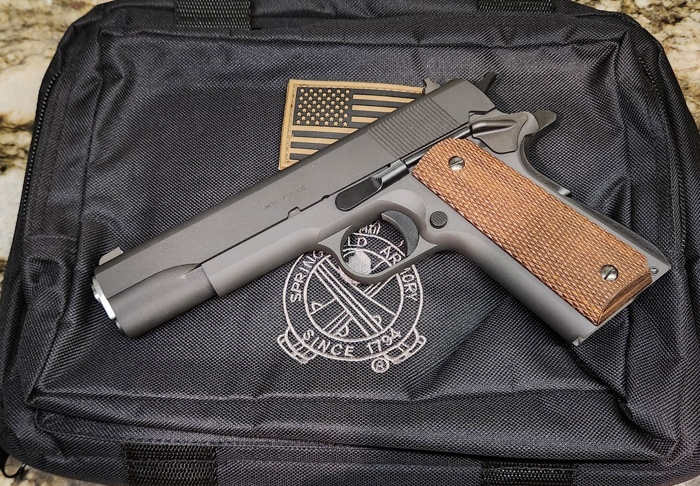

Got a deal on this with Case and three mags, the way they SHOULD come anyway.
I like the MEUSOC style guns but I was Army and don't care about "clone correctness" so I am going build like it's 2005, going to Iraq and the 9mm M9 just isn't going to cut it. I am thinking harrison TR ignition kit with commander hammer. Wilson match medium trigger. Cut in a Wilson beaver tail. Harrison rear sight, not sure on front maybe stock or trijicon or big green dot. Surprisingly the firing pin stop is NOT cracked lol, but will get replaced along with the extractor. Probably rock Pachmyer grips until I get the nerve up to checker the front strap. Can't decide if I like the curved Mainspring housing. Maybe a chen, will see. First order will be beaver tail and de mim. Then sights and grips. Going blend the beaver tail frame slide in back and maybe dehorn. Ounce the fitting is done i would to send it master gunworks for to give a ounce over and tune the ignition parts. Then try my hand at parkerizing. Off to order parts.
