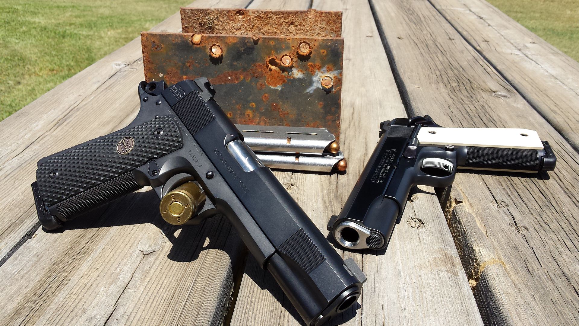

I have a Sig Nitron, and a Full custom from Harp. I'm not knowledgeable enough to tell a difference in the extractor function when I shoot, so to me, It makes no difference. Also, the look doesn't bother me at all. Now, if you want to talk ugly, lets talk about the Sig's square slide. Now that's ugly....
Very funny about the slide. Its interesting on how you can change one little thing from "perfection" and create something ugly!
