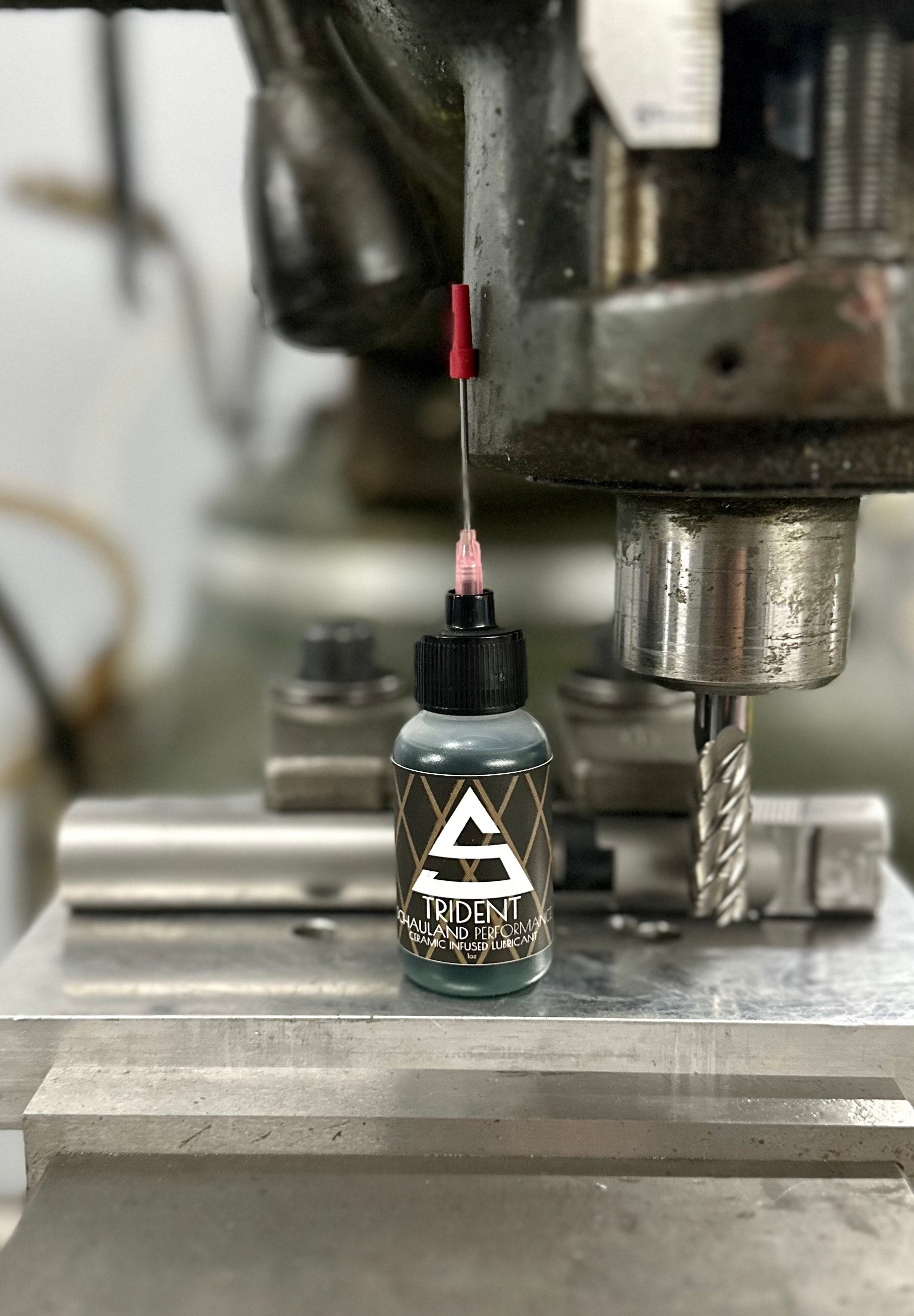

I use Trident from Rob, works great and stays where it's applied.

I stopped using TW-25B after I left my gun (a Sig 9mm) in my car console once overnight in subzero weather, took it in the next morning and discovered the grease had completely solidified. After discovering Trident, for occasions when I might need something a little thicker, I use Gun Butter. Besides, the more you think about it, grease just becomes a lapping compound once you start getting into the hundreds of rounds fired. Screw that.
