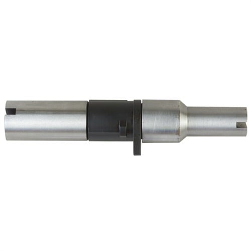

EGW makes good stuff. Again 1911 parts are not necessarily drop in. I bought this tool from Brownell's for fitting the EGW bushing and got a good enough fit to require a bushing wrench to take it out. Very pleased with the fit.
